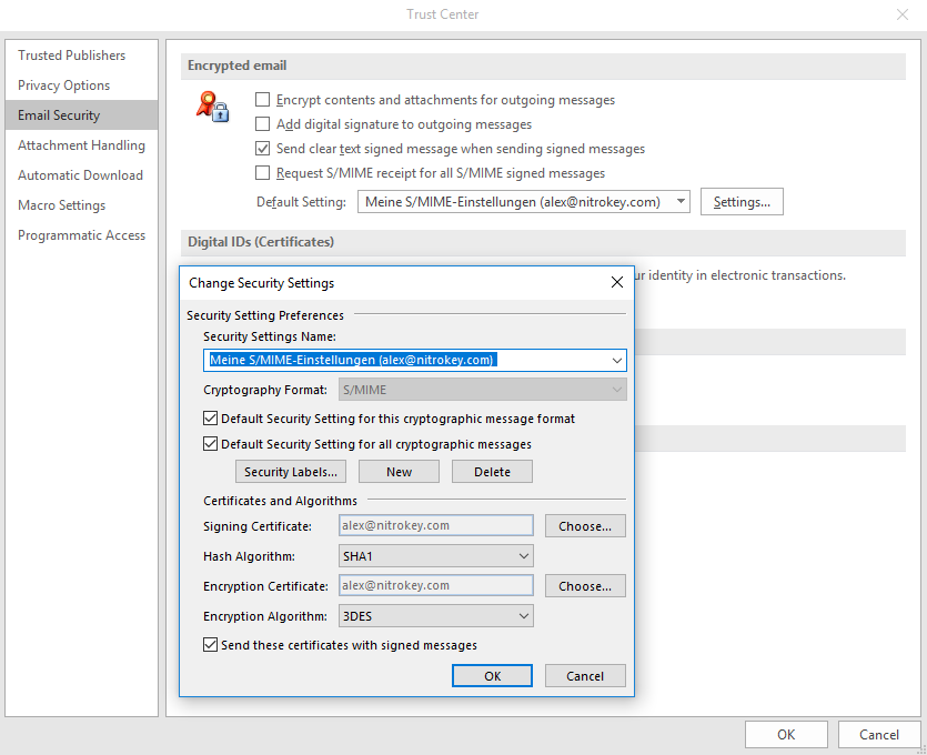

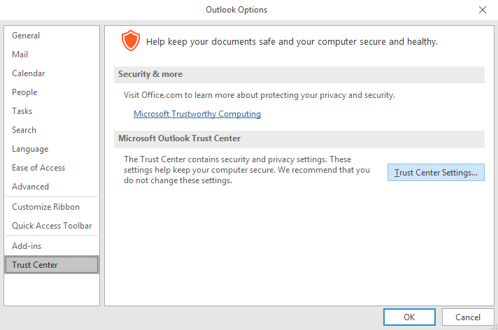

Instellingen in Outlook
Before you can use the Nitrokey in Outlook you have to activate S/MIME encryption. You can achieve this by clicking on to Start -> Options and clicking on Trust Center in the options window. In section Email Security you can choose your S/MIME identity. Your certificate should already be recognized by Outlook.

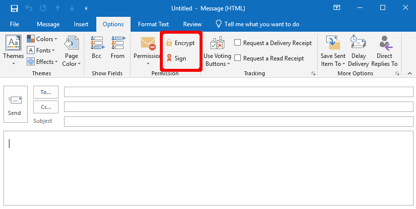

Gebruik
When composing a mail you can now choose to encrypt and sign the message in the Options ribbon of the compose window.
Notitie
Outlook will only encrypt message to mail addresses which are saved in your address book. So make sure, that the persons you want to write an encrypted mail to have an entry in Outlook’s contacts. You can ask the person to write you a signed mail, so that you can import the certificate information.
