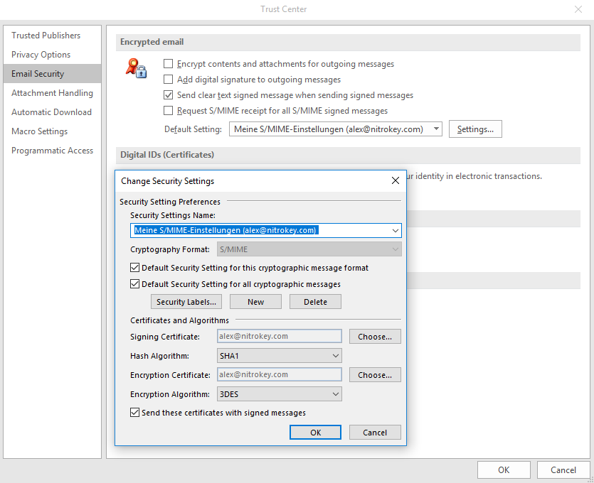

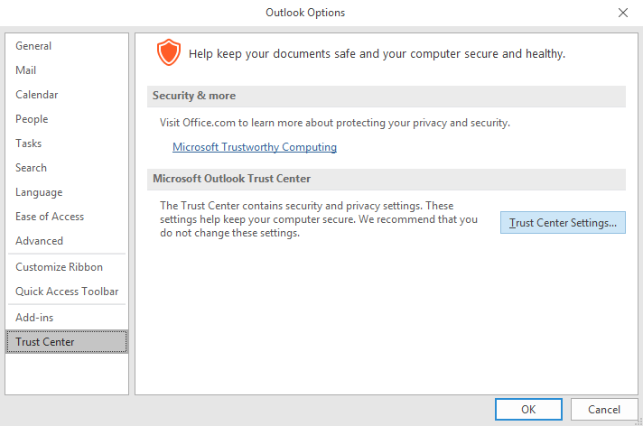

Before you can use the Nitrokey in Outlook you have to activate S/MIME encryption. You can achieve this by clicking on to Start -> Options and clicking on Trust Center in the options window. In section Email Security you can choose your S/MIME identity. Your certificate should already be recognized by Outlook.

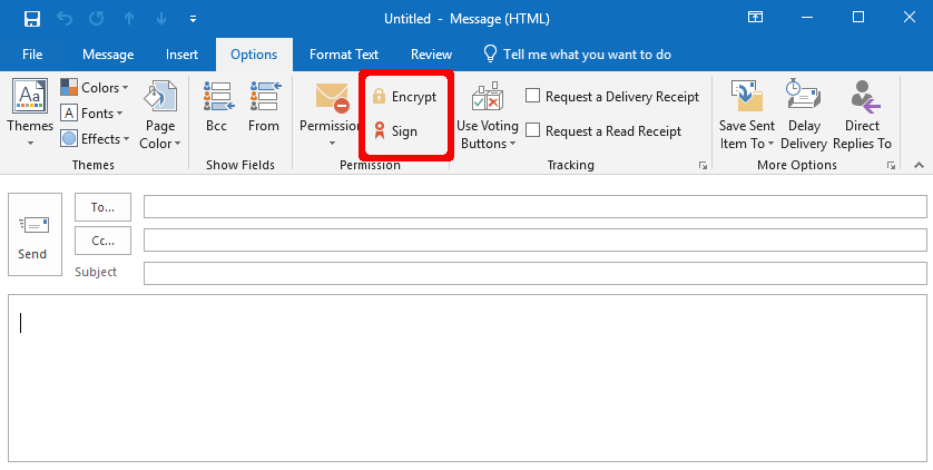

When composing a mail you can now choose to encrypt and sign the message in the Options ribbon of the compose window.
