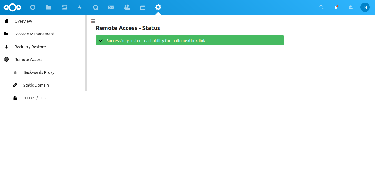

Enable TLS
On this page first wait for the status-bars to settle and mainly ensure that reachability of your NextBox is tested successfully. If this is the case, just click Enable TLS to acquire your TLS certificate.
Note
If the reachibility test fails, make sure your port forwarding is configured properly.
